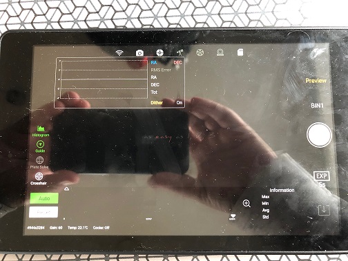

This is the first sceen after starting up the ASIair

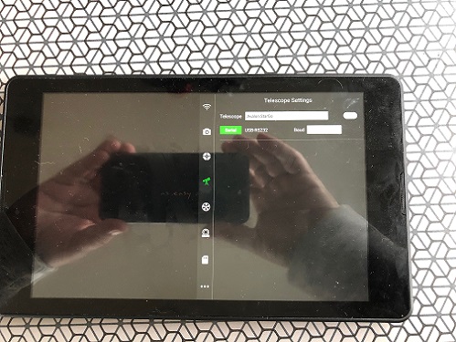

After pressing enter in the next screen it's clear that the mount is not connected
After pressing on the Telescope icon you enter the Telescope settings screen. The field with BAUD is blank there is however a pulldown menu with various BAUD rates

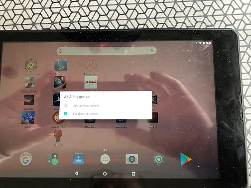

Upon trying to reconnect (I've tried all the available baud rates) the APP crashes

I'm starting to think that the ASIair client is crashing when it receives a property from the Avalon driver that it is unable to handle.
It may/should be possible to view the log files on the SD card as long as logging is enabled. They are stored under /home/<user>/.indi/logs The .indi folder is hidden
If logging is not enabled it might be possible to enable by connecting through another client like Kstars/EKOS or even PHD2 and enable logging through the INDI control panel
