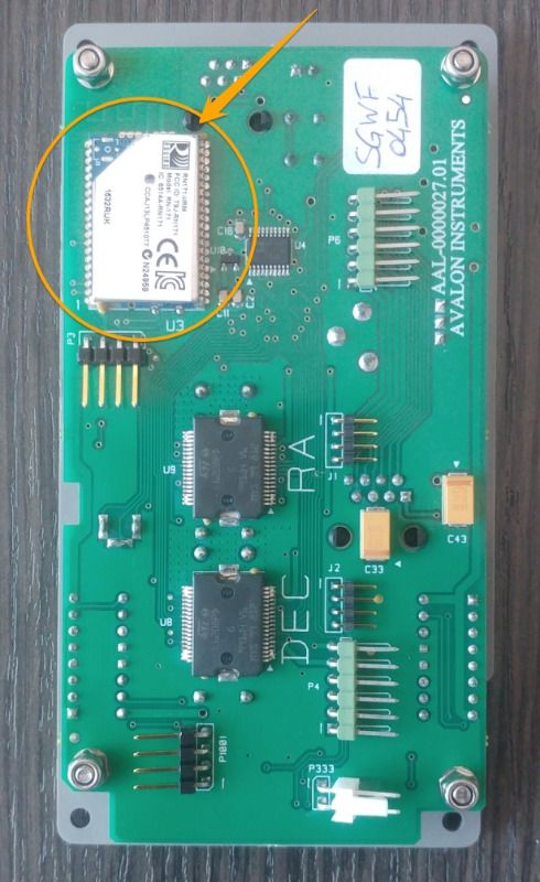

Here on the picture below, you can find highlighted, where the Wi-Fi chip is located on the StarGo board.

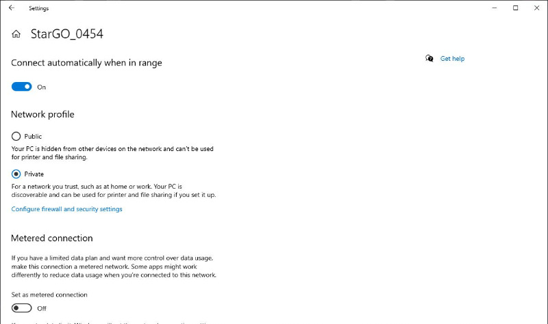

The StarGo wireless connection it was developed as a feature to use the mount without cables directly on the field, so, when you use the mount, we suggest to enable the “Connect automatically when in range” option for the StarGo network inside the Windows options and disable for all the others.
Please try in this way and let us know about.
