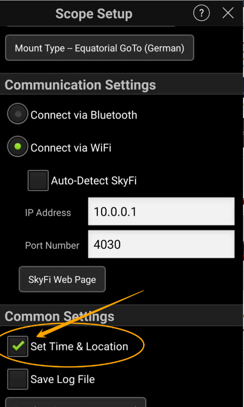

Hi Jason we need to know wich is the device that you are you using for the connection to the StarGO.
We suggest anyway some tips to improve the StarGO Wi-Fi connection and avoid noisy disconnection.
1 - First of all, on your device, disable all the automatic connection option with all your usual Wi-Fi networks, this is important because, in case of loosing/decreasing connection quality, the Wi-Fi connection protocol always search for more powerful wifi networks, at this point the connection with the StarGo is lost, that's why it is better to let only the StarGo Wi-Fi connection as automatic (if your device allows this option).
2 - Then if you are using Skysafari be aware that, when you set the "Set Time & Location", the connection needs exactly 60 seconds to be established. As this option it is only needed to update the location position, it is better to set it only once, then after the connection it is better to uncheck it, so after this, the connection will takes only a few seconds.

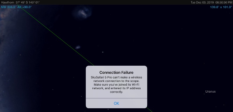

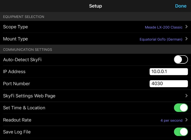

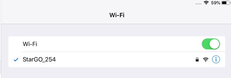

03 Dec 2019 10:42 #64 by jg
My PC runs Win 7 Enterprise 64-bit.
Connecting to my iPadAir for visual is when I would most like Wifi connection to work. Generally I am unable to connect via iPad (running 12.4.2 at present) and on the rare occasions I have succeeded it drops out after a couple of minutes at most. I have attached screen shots from my iPad showing connection to StarGo wifi, but inability to connect via SkySafari 5. .
And the SkySafari settings:
