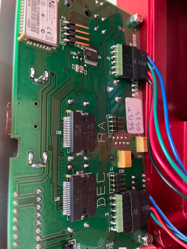

It seems very strange that I must set Reverse RA and I opened the StarGo today and took two pictures you can see below. So my question is:
- Are the blue, green, red and black cables on RA/DEC rightly plugged (I didn't unplug anything, this is the way it was assembled at the factory)?

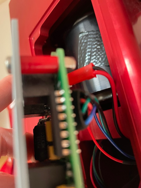

- At first sight, it seems that the cables on the DEC chip are not aligned the same as on RA side. However, upon close inspection they seem to be plugged in the same order (see second picture), however tangled. Could this be an issue?
- To resume: what cable order is needed for a Avalon Linear in order not to have to deal with RA/DEC reverse issues in the StarGo software?

From the pictures provided, it seems that the wires are fine plugged in the correct sequence: blue, green, red and black for both axis: DEC and RA.
