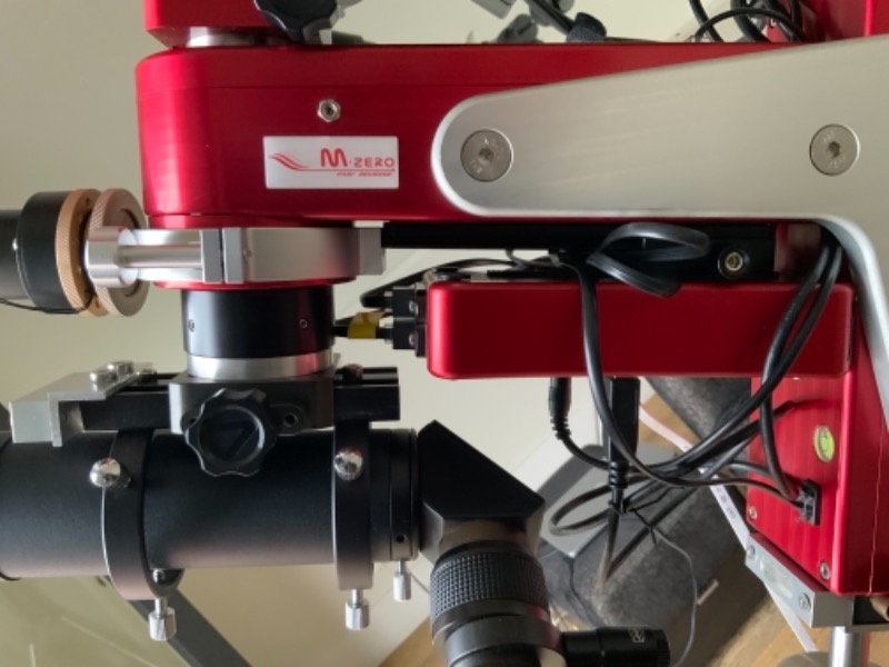

As others have done, I decided to mount the Stargo on the underside of my M0 using an arca rail & quick release clamp. I found the dual dec clamp knob could hit the Stargo at some positions so I added an aluminium spacer to give it the necessary clearance. Needed to use longer 19mm screws to fix clamp through holes in spacer and into dual dec block. Works fine
