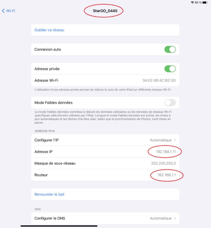

When I am connected to the stargo wifi network, I can see 2 IP addresses : 192.168.1.12 (my ipad) and 192.168.1.1 (the stargo module ?), but no 10.0.0.1 address.

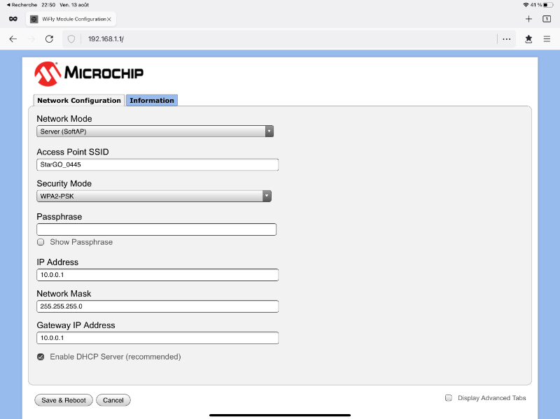

If I go to the 192.168.1.1 address in a browser, I can see "Microchip" configuration page ??

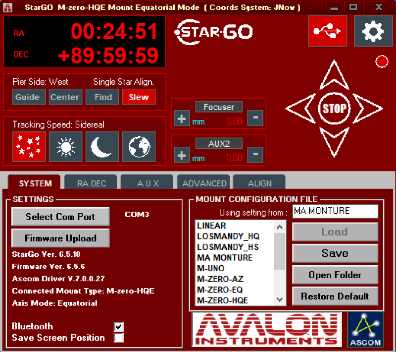

I have test the "StarGO_Tools.exe" program, the connection to the stargo is ok (via USB) but it can't read the wifi information.

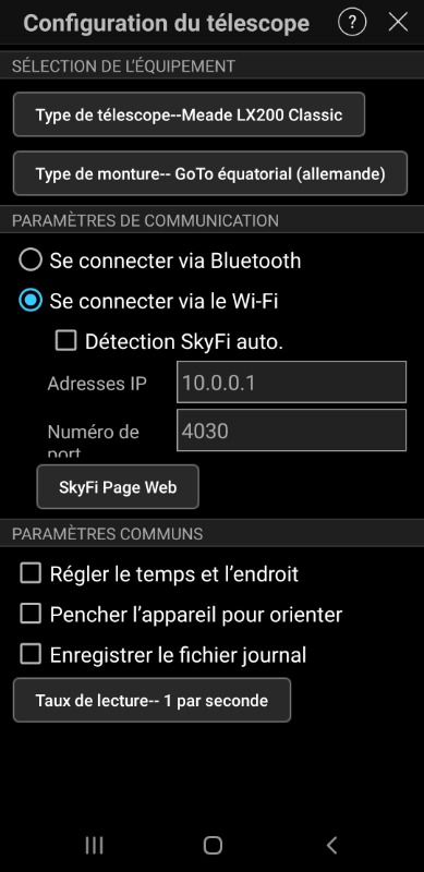

I reinstalled the firmware, try to use 192.168.1.1 and/or 10.0.0.1 address in skysafari,

In addition to what Stefano has said remember to set the port number to 4030 as reported in pag. 61 of the StarGo manual.

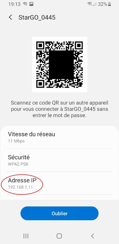

I think the problem is the assignment of IP addresses delivred by the Stargo.
You can see in the screenshots below that the Stargo delivred 192.168.1.X IP adress and It's not normal.
I have tested both IP adresses 10.0.0.1 and 192.168.1.1 in SkySafari but no way, What can do else ?
Here the setup of the two devices tested IOS and Android (the devices was not tested at the same time, no double connection).

By watching the screenshot provided, as noticed by your comments, it seems that the I.P. address deilvered is not correct.
At this point, if you agree, we can have a remote desktop connection with the AnyDesk app, in this way we can better understand what happened and eventually restore the correct I.P. address.
