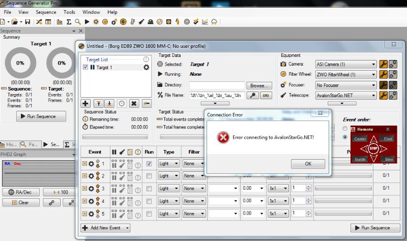

03 Dec 2019 11:23 #65 by jg
The same thing also happens with SGPro.
Must exit StarGo to connect with telescope via SGPro.

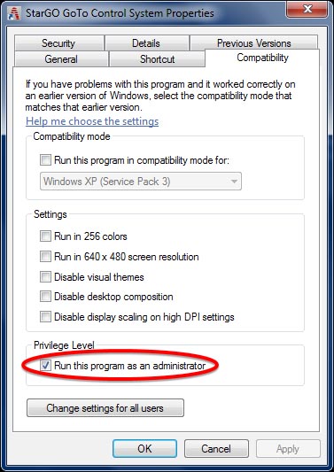

03 Dec 2019 11:36 #66 by jg
I figured it out - Both CdC & SGPro were no longer being 'run as Administrator' under Properties - somehow their tick boxes must have been unticked during updates of those programs, so please ignore/delete this post.

03 Dec 2019 12:35 #67 by Stefano82
Replied by Stefano82 on topic Connection issue with SGPro after StarGo update
Hi Jason
Thanks for reporting this behavior on the forum and yes, your reply it is correct..
To work fine and to be connected the StarGO Software and all other third party software ASCOM client must run under administrator privileges.
