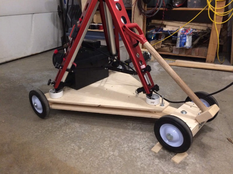

Anyone know of a dolly for the M zero OBS? Tip to tip distance ~23.5 inches. Thanks.
28 Mar 2021 23:50 #520 by G_Gagnon
Replied by G_Gagnon on topic Dolly for Mzero OBS?

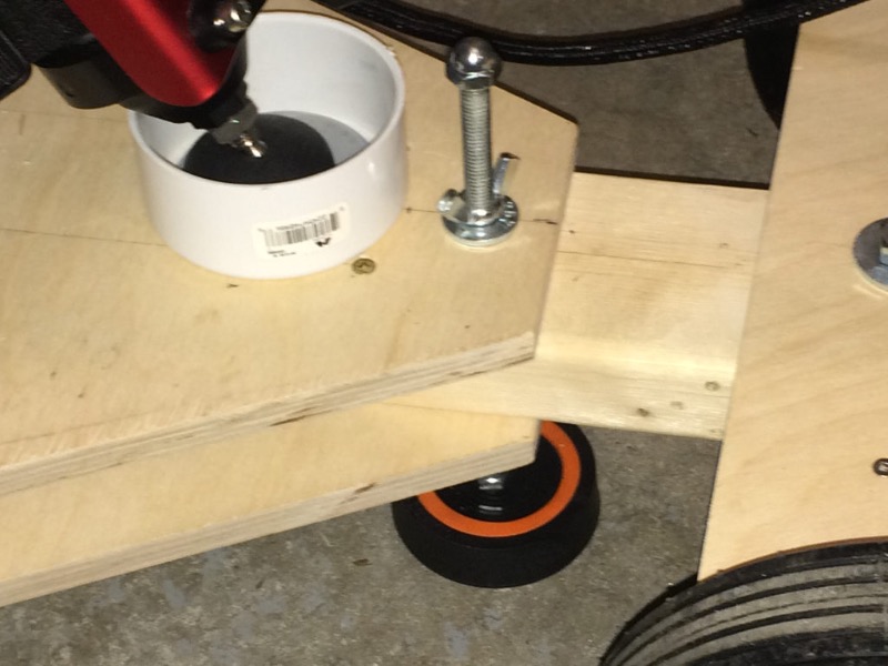

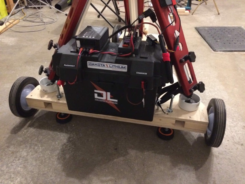

I built one out of 1/2 inch 9 ply plywood and 2x3 lumber, with 8 inch lawnmower wheels and levelers (3/8-16 steel rod, 10 inch long). Fairly easy and quick to build, it 32 inches on a side, it was meant for my Avalon M-Uno with TPod 110 but could be used with the M-Zero Obs.
I attached a few photos.

Thanks for your reply and the nice, helpful images. I especially like the use of a shovel handle! This is great!
