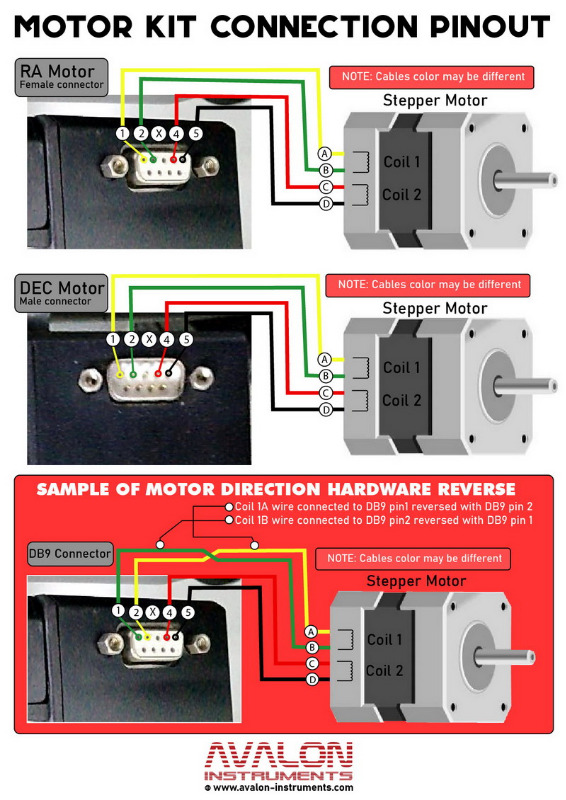

I have the early Stargo Bluetooth Controller and TREX drives as mentioned on my other forum posts.
I am looking to get cabling diagrams (connection pinouts) for the cables that run from the RA and DEC ports on the Stargo to the RA and DEC motors as I need to get 2 new cables manufactured to replace the old originals.
Thanks for any help !

Is the diagram attached at this topic and also available on the T-rex product page what you are looking for?
www.avalon-instruments.com/products-menu...-motori-t-rex-detail
Let us know about it.

Yes I did see that but it appears to only be a diagram of the internal wiring from the Motors inside the housing to the external DB9 interface on the outside of the housing.
I am after the Wiring diagram of the Cable that connects the StarGo box DB9 ports to the Motors DB9 Ports .......that is 2 x ( 2 meter DB9 to DB9 cables ) ie is that a straight through cable?or are there any crossovers ?
Cheers
Phil

They are straight through cable and there no crossover.
In case you wish to reverse motor direction, you can do it by softwareby using the "REVERSE MOTOR DIR." option inside the StarGo GUI.
If you wish to do it by hardware, you have to reverse the wires in the cables, following the diagram instruction of the Motor Kit Connection Pinout.
