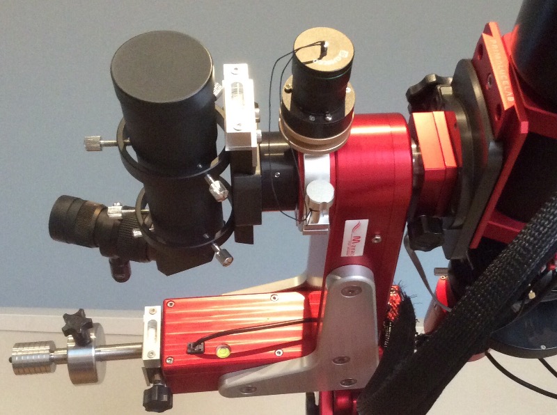

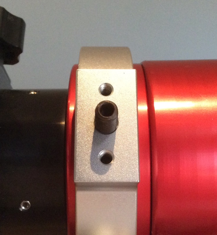

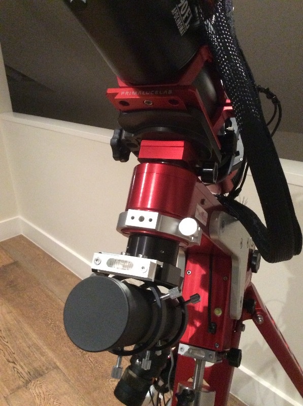

16 Dec 2019 11:46 #87 by jg
Replied by jg on topic iPolar adapter for M-Zero
ducksoup87 wrote: The idea is to be able to polar align while the scope and counterweight are already mounted.
I think a good place to mount a polar cam other than on the fixed M0 dovetails, is on the non-rotating round, lower portion between the two DEC axis clamps. The diameter of this is ~78 mm which is the same as ZWO cameras, so you can use their camera holder clamp and simply fasten your ipolar, sharpcap cam or Polemaster adapter to the holder using a diy adapter plate. See pic of holder on M0, it fits perfectly. I’m planning to use a small piece of Al flat bar as a connector plate that I will fix to the threaded holes on the ZWO holder and then tap holes to screw a Polemaster adapter to.
M-Zero WiFi user

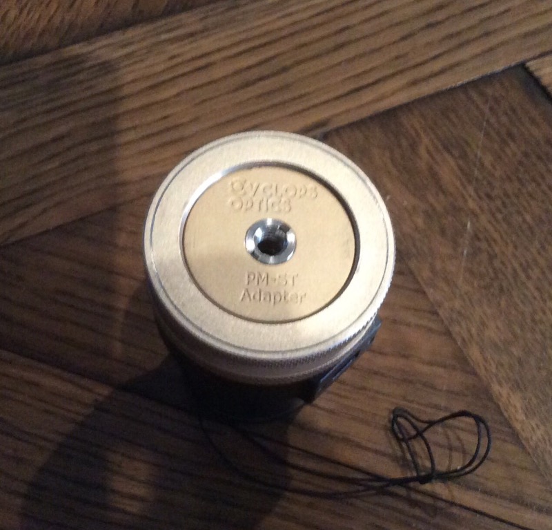

17 Dec 2019 19:19 #88 by jg
I worked out I don’t need to make an adapter plate. I have a Polemaster universal adapter from Cyclops Optics, I fitted a 1/4” photo adapter into it and then used a 1/4” set screw to fix the universal adapter to the ZWO camera holder - all done! PM is held firmly in place and I can now monitor polar alignment during an imaging session if I want to. I’m sure something similar can be figured out for the iPolar...
