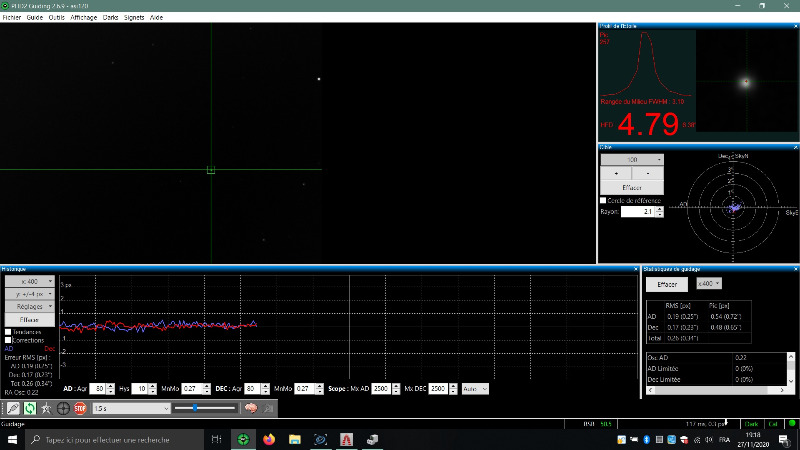

hi
I've the same setup : m-zero + T100Q + asi1600
my technique :
1- make a good stationing using sharpcap polar alignement, take 10 min max (it's free)
2- have a good focus on guide scope because avalon motor adjust a little everytime.last week
exemple last week :
Emmanuel (from France)
Last edit: 01 Dec 2020 15:27 by maudet. Reason: picture format
