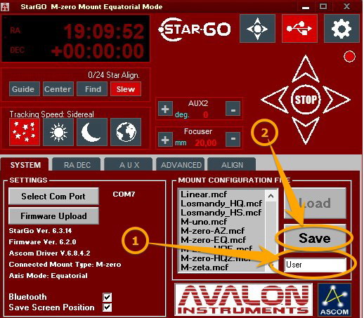

Please provide the error message screenshot and a screenshot of your Device Manager window when all devices are connected.
Would be also really helpful if you could provide us your mount configuration file.
To save your own mount configuration file, with the StarGo Software opened and connected, go to the “SYSTEM” tab → “MOUNT CONFIGURATION FILE” box and type inside the field at the bottom right your preferred mount configuration file name, then click on the “SAVE” button.
Then you will find your own mount configuration file inside the StarGo Software folder.
