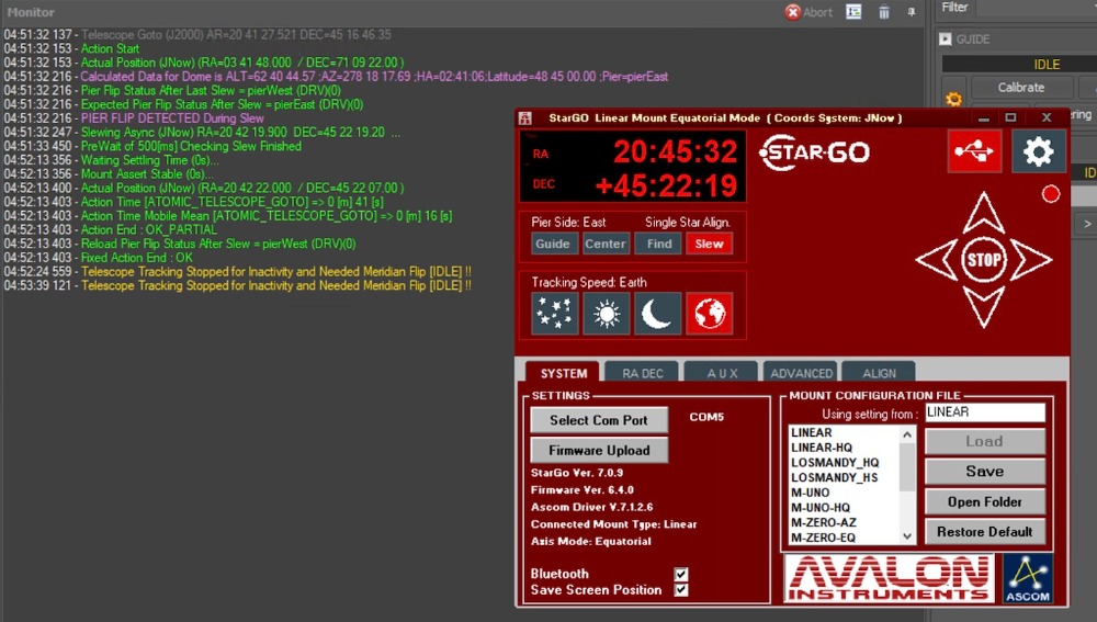

The avalon ascom driver take a very long delay (more than 5s) before reporting the change of the side of pier, and my sequencing software ‘voyager astronomy’ activate a meridian flip watchdog and stop the mount
Here is a screenshot after that the problem...
This is now a consistent and repeatable error.
The time of the PC is synchronized to an atomic clock and the bios battery is not depleted.
As you can see in this screenshot, the ascom mount has finally switched to Pier Side East but it has done this after a too long delay and when voyager is requesting the mount driver, the side of pier was pierWest (Reload Pier Flip Status After Slew) which is wrong according to the position of the scope !
How can we dig together to solve this problematic behavior ?
Thank you for your help in advance.
