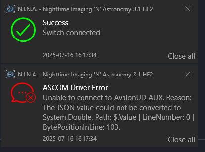

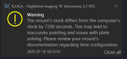

16 Jul 2025 14:47 #1408 by Filip
Replied by Filip on topic Ascom - Alpaca despair
Reporting back after installing the patch, thanks for the instructions.1 telescope driver: the mount seems to connect now and can be controlled, but gives in NINA an error with time syncing with every reconnect2 focuser: this connection works without error message (but I don't own an Avalon focuser)3 switch: this gives an error, then a message that it is connected, but no switches in NINA appear, so the USB / camera / filterwheel cannot be found.
Kind regards, Filip

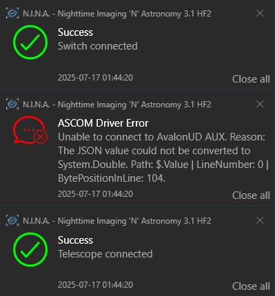

16 Jul 2025 23:45 - 16 Jul 2025 23:46 #1409 by kfiedosiuk
Replied by kfiedosiuk on topic Ascom - Alpaca despair
I have the same problem with my StarGo2 (M-due):

17 Jul 2025 08:13 #1411 by Stefano82
Replied by Stefano82 on topic Ascom - Alpaca despair
Hi all
Thanks for the feedback, we are working to check and fix this.
We'll let you know ASAP.
