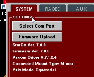

29 Nov 2023 16:56 - 29 Nov 2023 21:23 #1245 by Peter_S
thank you Stefano!
I was not and am still not aware if my one (7.0.0) is the B5....
meanwhile I installed the suggested 640 SP 7
StarGo is now 7.0.8 and fw is 7.0.0.
I can´t get the firmware to be installed - if I use StarGo GUI: System / firmware then StarGo shuts down.
If I open the fw loader in the StarGo folder it says: "not found"
any ideas?

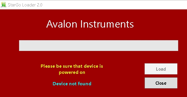

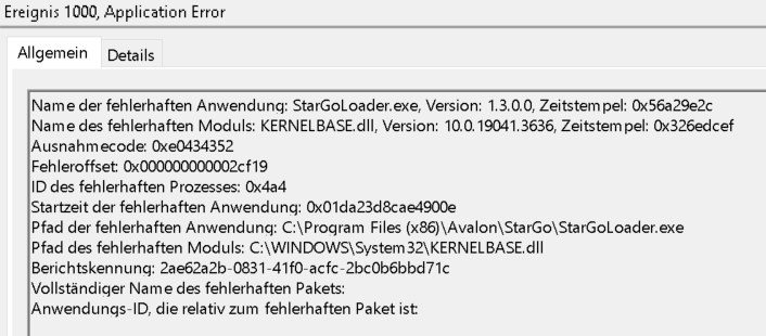

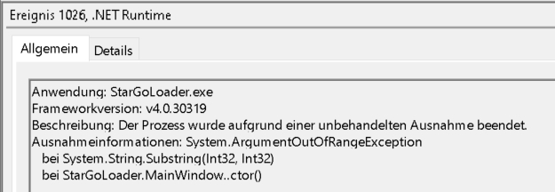

30 Nov 2023 22:58 #1248 by Peter_S
thanks again but it does not work - just to be sure:
the previous installed version was StarGo 7.0.0.B1, which is not the "EVO" version (?)  - it is not listed anymore on the support page. I now re-installed  7 0 0 B1 but even with this version the fw updater leads to a StarGo shut down.
with the 640 SP7:
with any version:
windows protocols: unhandled exception / out of range
