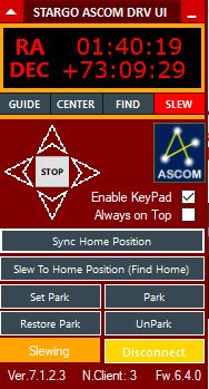

On the basis of your report we performed further tests and debugging on the driver and we found that, as suggested, after received the Park command the mount, even though the motors was moving, the driver reported the "No Tracking" status on the "STARGO ASCOM DRIVER" panel.
After this check we was able to work on the driver and now we can share a Beta Version that prevent NINA to display the Warning error message after the Park command is sent from within the software. At the same time, while the mount is slewing to the Park position, the status reported from the STARGO ASCOM DRIVER panel is set on "Slew" (see attachment), which means that NINA should have no more problems.
The Beta version is available on the following temporary link:
www.dropbox.com/s/bcfum4a9mjrekev/Avalon...p%207.1.2.3.exe?dl=0
Try this version and let us know about

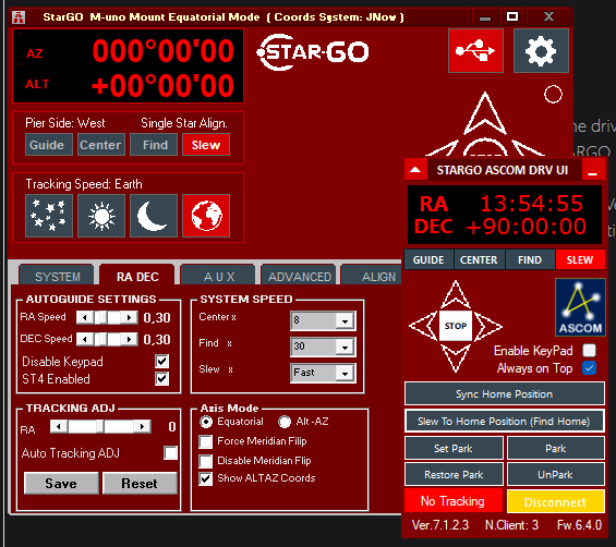

30 Mar 2023 19:28 - 30 Mar 2023 19:30 #1144 by Sturaro
Replied by Sturaro on topic NINA Park fail
this version works very well, both on Parking and on Finding Home.
Both NINA and a custom utility I've build works as expected.
Only the issue, already present in the previous beta but not on the official release, about ALT-AZ coordinates always zero still exist, as you can see in the attached image.
Anyway it is usefull (I show the current scope position in my control panel) but not madatory.
Slewing to AltAz coordinates work as expected (eg. pointing to Zenit for sky-flat).
