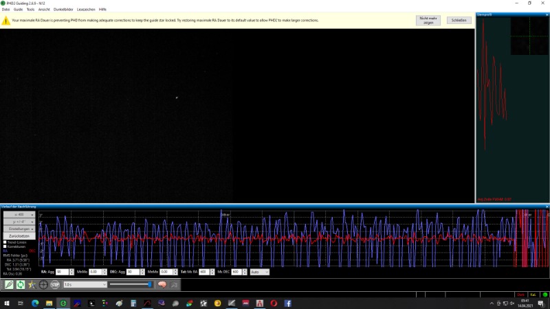

I use a Avalom Uno and have set the given parameters on a PHD2.
The guiding also runs very well and smoothly.
But if the seeing gets worse, corrected in Ra more and more and these fluctuations occur.
These are not as strong as here, the screenshot was taken at dusk, where the effect is very strong.
With normal seeing, as I said, the curve is also smooth and the result is round stars.
This phenomenon does not occur in Decl.
I do not record at dusk, the screenshot is only taken there. Otherwise you won't see the effect.
the reference text in PHD reads:
your maximale RA Dauer is preventing phd from making adequate corrections to keep the guide star locked.
try restoring maximale ra dauer toits default value to allow phd to make larger corrections
Thanks for help, Stefan

here is the guidelog.
But I always focused, then after 1 a.m. I didn't do anything.

I have used gudeassistent and it works
Stefan
