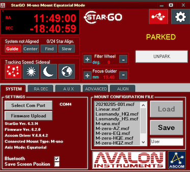

In order to better help you, could you please provide us your current StarGo firmware/software version?
Did you check that the correct mount configuration file has been selected? Please send us the StarGo System tab screenshot.

04 Mar 2021 19:41 - 04 Mar 2021 19:48 #496 by Duszanowicz
Absolutely. I enclose the image with system settings.
Yes, config M-Uno file is chosen.
After power on the mount, the command "Slew to Home Position" is used. After that, the TheSky X program is started and communication with the mount is activated (ASCOM). Since I use the built-in T-Point system, M-Uno move the scope to chosen objects quite well. The problem comes down the command Go-To is complete. The mount must then again follow the starry sky's apparent movement (sideral tracking), this takes place not directly but takes a few minutes before this is stabilized.
