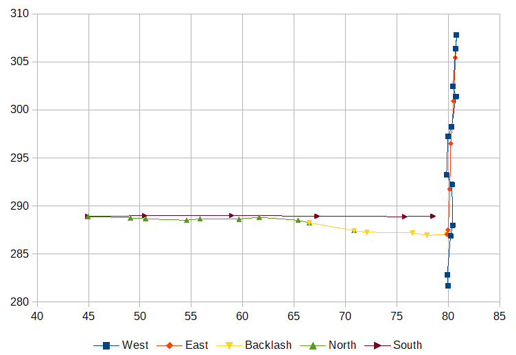

The attached graph shows the raw calibration movements in pixels.
The west leg shows erratic guide pulse movements. Short ones in between longer ones. However it is straight.
The east leg has evenly spaced guide movements and returns along the same path but stops short of the start position. The pulses on this leg are longer due to the fast return option being used. 2500ms pulses vs 1150ms on the west leg.
There is a bit of backlash correction but that appears to be an artefact of the dec movement.
The north leg shows the same erratic pulse lengths as the west leg. I think PHD2 interprets the short movement as backlash. The north leg is orthogonal to the east/west leg
The south leg is similar to the east leg and has evenly spaced pulses - also longer than the north pulses: 2500ms vs 1150
After calibration the guide rates based on the calibration results come out at 6.9 as/s RA (0.46x) and 8.1 as/s in DEC (0.54x). This can be due to an incorrect focal elngth specified but it it also affected by the unevenly spaced pulses west and north.
Overall the calibration looks reasonably good.
