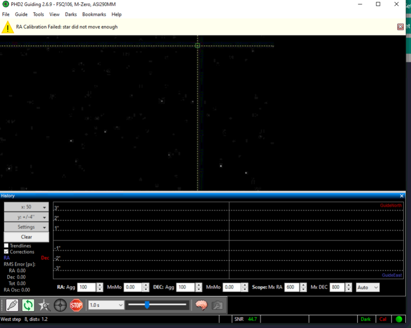

I have been trying for a while now and am struggling to get PHD2 guiding working with my M-zero.
I have followed the guide parameters and also searched other forums, I am sure I have everything set right, the mount is level and well polar aligned (using iPolar) but I continue to get the message "RA Calibration failed: Star did not move enough".
Any assistance would be greatly appreciated!

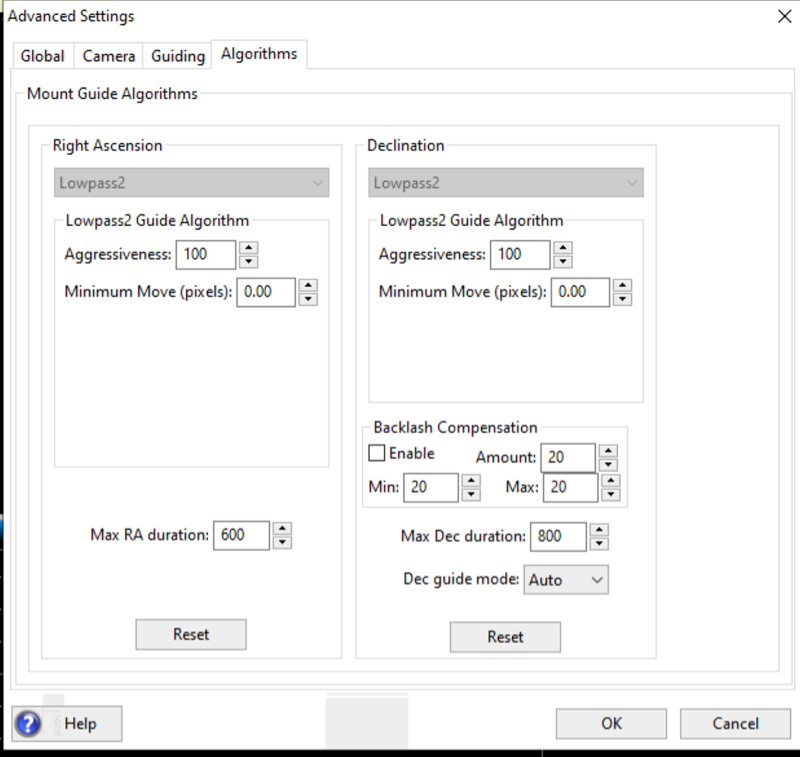

I've attached screenshots showing my settings.

Dear gregk
Did you install and run PHD2 as administrator?
Please let us know about it.
18 Aug 2020 18:34 #384 by gregk
Replied by gregk on topic PHD2 and M-Zero
Hi Stefano, No I did not.
Now running as admin and problem solved.
