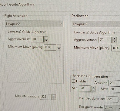

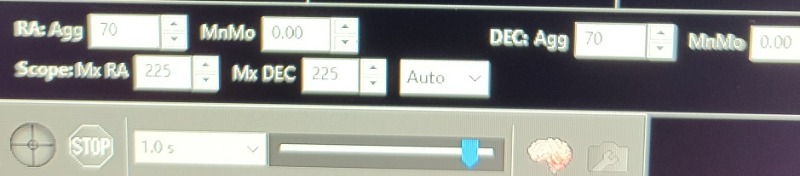

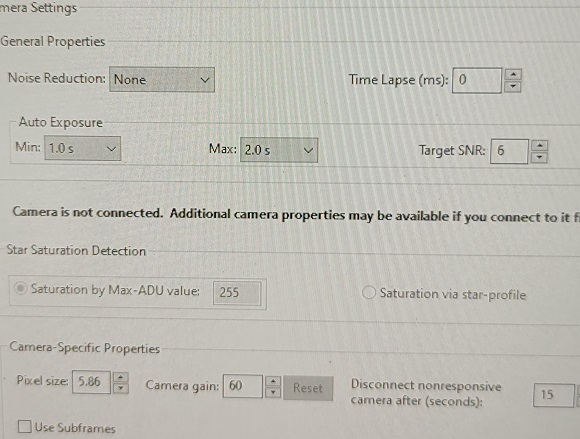

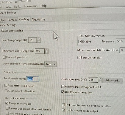

Here is my setup:
m-due
10" RC with focal length of 2032
New zwo 2" OAG
Zwo 2" filter wheel
Zwo ASI 174mm for guiding
phd2 on a intel i7 (nuc)
speed ratio guiding: 0.2 as suggested in the 'phd2 guide parameters' article on your support webpage
Other parameters of phd: see attached picture
Regards
Chris

My parameters / Suggested parameters
Max duration: 2500/200-300
Aggressiveness: 30/70
Min move: 0/0
Algorithm: Lowpass2/Lowpass2
Exposures: 1s/1s
Autoguide speed: 0.2/0.15-0.25
Multistars in phd enabled.
Regards
Christian Granwehr
